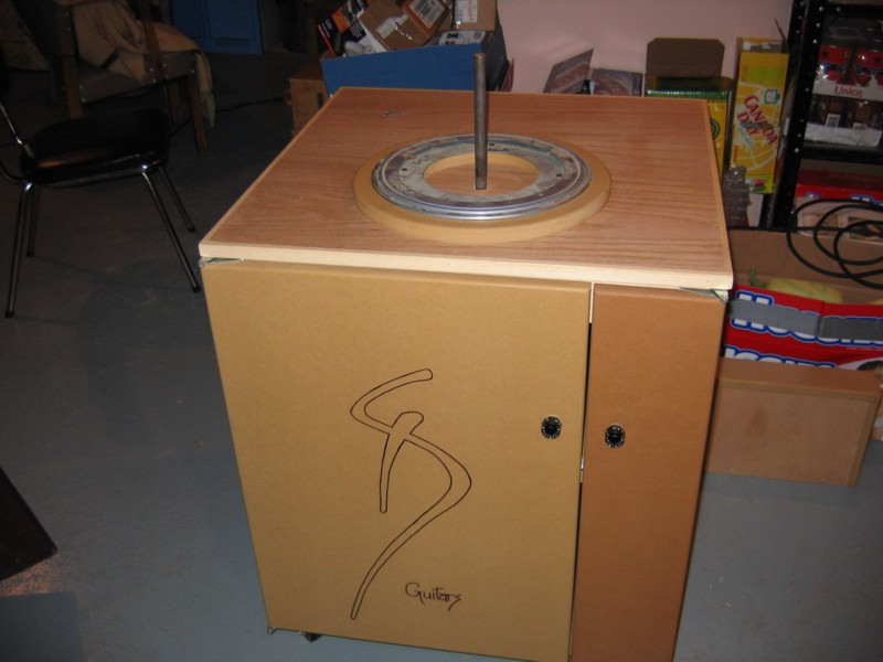

Well....My top is ready to brace and I want some go bar dishes. I knew that eventually I would also want a rim sander. And since you have to spin the discs to make dishes with a router sled I thought I may as well just build the rim sander and have it spin the discs! So I printed Tim McKnight's post in the jigs and fixtures section and then asked Tim what he didn't like about his machine. He just said that getting the belts tight was a bit of a choir and thought that maybe a chain drive would be better. I am not into chains so I stuck with belts but I think that the system I came up with will make tightening and keeping tight those belts not so problematic. I am not finished the sander yet as I have to build the chuck to hold the dishes but I will do that very soon. So here is the sander.
I thought you might like the electric guitar 'speed knob' knobs! The undished discs are in the shop, four in all two each for the back and top, one to fasten sand paper to and the other for the go-bar deck. They are 2 ply of 3/4 MDF, just like Tim's except I went to 24 inches in case I want build an acoustic bass.

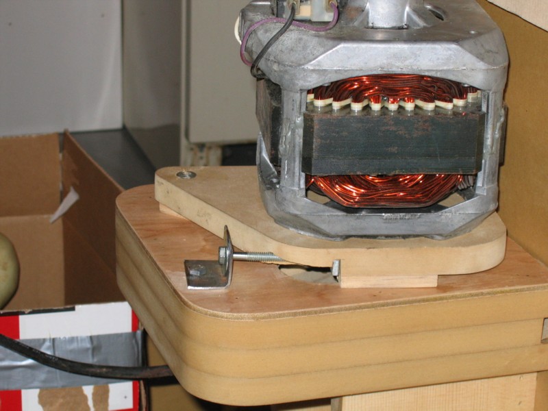

Here is the motor tightening mechanism, quite simple really!

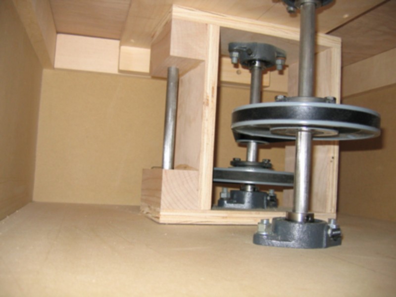

And here is the idea to tighten everything up. I stole the idea from the idler pivot that is on my 12 speed drill press. The shaft and two middle pulleys are in a box that pivots so when the motor is tightened the center block pivots and everything comes tight. You cannot grab that spinning shaft and stall it out. It works GREAT!
My sander is probably a bit slower than Tim's. My math with his pulleys says his turns at about 155 rpm and mine turns at about 127 rpm. Mine is also probably turning in the opposite direction as Tims because my motor is upside down and is held in place with a pivot pin (3/8 bolt, with no nut). My motor is 1/2 hp washing machine motor that a friend of mine who owns an appliance repair business gave me. I have a cover for it that I took off to show these pictures. My pulleys are 2" on the motor to a 6" then another 2" to another 6". Some thoughts for the future are to construct my moulds so that I can set them on a frame on the sander deck and lower them onto some stops. This will give me cosistent results everytime but it just an idea for now.
Thought I would share my long weekend project!

Very Nice, and I like your idea about the stops for consistancy. All that in a weekend? WOW!

The dish RPM is easy to accurately calculate. Devide the motor's RPM's by the ratio.
In your case, 2" to 6" yields a 3:1 ratio, and double reduction multiplies it twice. 3x3 is 9, giving you a 9:1 ratio.
What's the motor's rpm's? If you're running the typical 1725(1750?) motor, you're rpm at the dish will be 191(or 194). Too fast, and you'll not have enough torque to do the sanding(there's a LOT of friction with all that sandpaper against the guitar's rim).
When I designed and built this machine, I ended up gearing it with a 16:1 ratio, using a 1-1/2" on the drive and a six inch at the driven(4:1 ratio), with the double reduction. With the 1725 rpm motors, this brings it down to 107 rpm. Much more torque availble(78% more torque with 16:1 than with 9:1), and way more importantly, much safer. Your speed is dangerous for spinning such a large dish!
You can keep the 6 inch pulleys, but change the drives to 1-1/2" pulleys, please. Trust me; I had mine geared like your's is currently, at first, and it just about tossed my dish across the shop like a frisbee the first time it came up to speed. I made this an important point when i shared this machine on the MIMF, where Tim saw it and took it to the next level with its own cabinet.
Doesn't Tim mention and explain this? I haven't read his write-up on it, but the gearing, and proper reduction, taking the motor rpm's into considerations, is of utmost importance!
Also, be aware that your open frame motor will spark in use, especially while under load. This machine wil make a lot of fine dust, while under load. Fine dust and sparks don't mix well... Try to enclose the motor(but keep it vented at the same time..) if you haven't yet.
Don't mean to be scaring you, but I'd hate to hear you lost your shop and/or home because of this oversight...Mario38603.1175115741

My word. Everything looks so clean on the inside. It looks like you wiped up all the glue spills and sanded the interior. Very guitar like. Exterior is pristine as well. Impressive attention to detail. I do second mario's concerns about speed and dust and sparks.

Shane, I like what you have done with the tensioning system and now you have taken this design to another level. I also concur with Mario and John ... consider changing the motor to a TEFC NEMA rated design which is MUCH safer. Appliance motors are just not safe for this application.

Thanks Mario for your comments. Tim did explain it and I took it to heed. My motor is dual speed so I have it set at 1140 rpm, leaving my dish RPM at 126. That will work I think because it is a bit slower than Tim's. Also I do have a motor cover, it's off for the pictures.

126 rpm sounds good, but you may still not have enough torque. If that happens(and it will, unless that motor has a lot more torque than I think it does), you'll need to change the pulleys, but at least now you'll know which direction to go.

Shane the thing that is nagging me from your pictures is what are you going to use to inlay your cool logo sketched on the side of your machine? Can you get Ablam that big? <VBG>

I was thinking maybe excavate and then inlay pebbles. Might be a bit heavy but hey it would be different.
